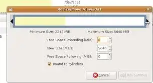

Now that the home partition and the unallocated space are contiguous, you should be able to resize the home partition (sda11) by clicking on on it, then clicking resize, then by dragging the right edge of the rectangle in the pop up menu. After you tell GParted you want those operations to be done, you have to tell it to apply them (click the green check mark). It may take a while, but it should work without problems.
