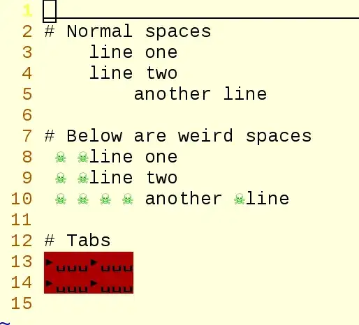

In my case I had to fight nbsp,
:set listchars=nbsp:☠,tab:▸␣
:set list
You can also use ␣ instead of ☠
Here is an example where the above vim config highlights the "invisible weird" spaces and additionally it highlights tabs (red color because I am using trailing-whitespace vim plugin)
Here
