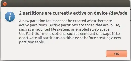

Here I don't know what should I do. Is it impossible to resize this partition?

The main problem seems to be that you are trying to work on the disk and on the partition layout from within the running Ubuntu operating system and this is not recommend, also creating a new partition table is not possible.
Boot from the Ubuntu installation media and select 'Try Ubuntu without installing'.
On the Live desktop open GParted, right-click the swap partition and click swapoff.
Now you can create a new partition table. But is this what you really want to do ?
When you create a new partition table, the whole disk will be erased completely.
Maybe you just want to resize partitions ?
