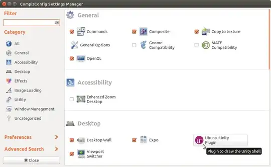

When it's installed, launch it with the command ccsm or search it in the Dash.
You will see a window like this:
CompizConfig Settings Manager - Plugin Overview

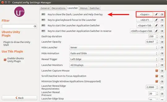

Select the Ubuntu Unity Plugin, then switch to the Launcher tab in there.
The first option is what you're looking for:
Key to show the Dash, Launcher and Help Overlay
You can set a new shortcut or entirely disable it using the three buttons on the right.
CompizConfig Settings Manager - Ubuntu Unity Plugin - Launcher
