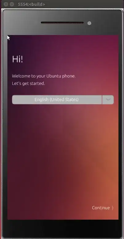

A screenshot of all of this running on my own system:
