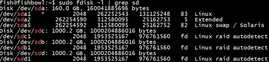

I'm trying to configure RAID5. I know this question has been asked before but I have been stuck on this for 3 days.
Input:
sudo mdadm --create /dev/mdo --level=5 --raid-devices=3 /dev/sdb1 /dev/sdc1 /dev/sdd1
Output:
mdadm: cannot open /dev/sdb1: device or resouce busy
Input:
umount /dev/sdb1
Output:
umount: /dev/sdb1 is not mounted
Input:
lsof /dev/sdb1
No output... nothing displays.
Rebooted machine uncountable times.
Here is a screenshot with my drives:
View of disk partitions
I have also reinstalled Ubuntu server twice in the past 48 hours.
According to this blog you should use the following procedure to avoid contention on device handles:
$ sudo udevadm control --stop-exec-queue
$ sudo mdadm --create /dev/mdo --level=5 --raid-devices=3 /dev/sdb1 /dev/sdc1 /dev/sdd1
$ sudo udevadm control --start-exec-queue
