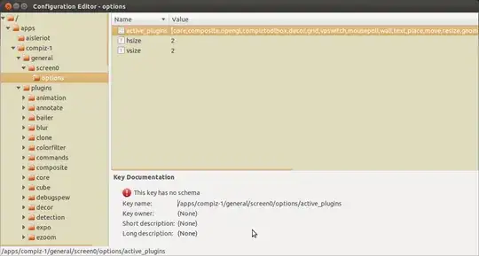

At least in 11.04 & 11.10 this will give you a list of the enabled plugins inside of brackets. []
 gconftool-2 --get  /apps/compiz-1/general/screen0/options/active_plugins
you can take that list, add to or subtract and then set with this, using " around the brackets "[]"
gconftool-2 --set --type=list --list-type=string /apps/compiz-1/general/screen0/options/active_plugins "[list,goes,in,here]"
