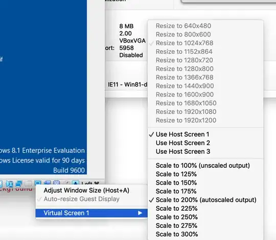

you need to install an extension pack which is available at:
https://www.virtualbox.org/wiki/Downloads
I found there's an option at the bottom right corner of the window.
Screenshot Pick the icon between the folder and recording icon. Choose 'Virtual Screen' in the dropdown then you'll be provided a whole bunch of resizing options. Pick one that fits your testing purposes.
Kulfy
  • 18,154
