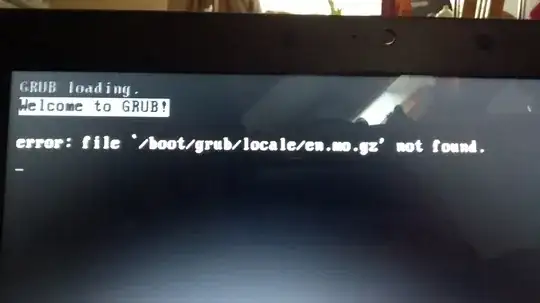

Now when I boot, first I get a blak splash screen:
grub black splash screen

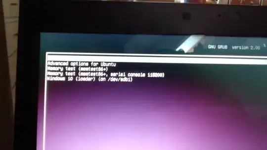

Then, immediately it goes into the normal purple grub2 splash screen:
grub 2 splash screen
My inital guess is that somehow I ended up having both grub and grub2 bootloader! I would like to know how can I get rid of the first one, because I use the second one now to also choose to boot in windows sometimes.
Also what can I do about that error message of grub? I hope I can get rid of the first one because it delays my boot time for about 5 seconds.

I don't know if this will solve your problem, but you may give it what it wants. First of all, see what locale files you have on your system:
cd /
locate grub.mo
My output looks like this:
/usr/share/locale-langpack/en_AU/LC_MESSAGES/grub.mo
/usr/share/locale-langpack/en_CA/LC_MESSAGES/grub.mo
/usr/share/locale-langpack/en_GB/LC_MESSAGES/grub.mo
/usr/share/locale-langpack/ro/LC_MESSAGES/grub.mo
Basically, get one of these files (the one you're interested in), compress it to gz and copy it to boot folder of GRUB.
sudo cp /usr/share/locale-langpack/en_GB/LC_MESSAGES/grub.mo /boot/grub/locale/en.mo
Now, according to this claim, GRUB looks first for mo files and if there is none, looks for gzipped one. So it should be enough to fix your problem. Yet to be completely sure, do:
gzip /boot/grub/locale/en.mo
And definitely you don't have both Grub and Grub2 installed. That is just an error message telling you that Grub is missing a localization file.
