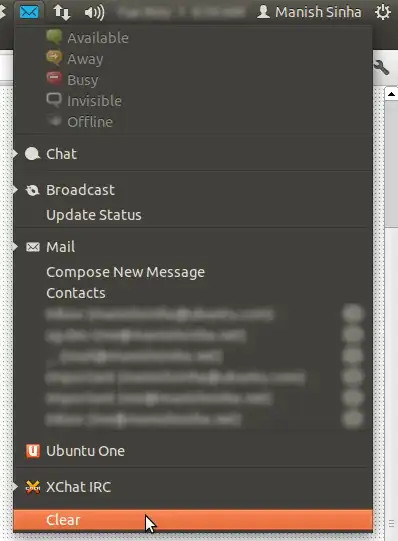

As far as I know there is currently no way of clearing all the notifications in gnome-shell. Is your bottom screen like this? (not Firefox, but any applications flooding the lower panel)
I tried searching all the design documents on wiki and still cannot find any design or spec for clearing all the notification.
You can request this feature by opening a bug report here
Extra Info: Clearing in Unity
This is one use case where passive notifications with App Indicator makes a lot of sense. You don't need to be bothered with notifications pilings up. Those notifications which need your attention show in app indicator and can be cleared
