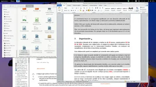

If the requirement of a full-emulated virtual machine is not hard, you can try with emulation through wine. If that fails, I do not know how it will work with Office 2013 (I use 2010 at my university), but I am really satisfied with Crossover.
It is not a free software (it is built over Wine and contribute back to it, but it is much more compatible with new softwares) --- so you could test first with wine (which is a FOSS solution) to see if it works.
Once installed, I have installed Office 2010 through it, and now it is seamlessly integrated in the desktop. Through the configuration interface you can choose, for example, to open .docx files with Miscrosoft Office and .doc with LibreOffice with ease.
It has some glitch sometime, and you need to choose click-to-focus to make it work, but it works well (at least, Word, Excel and Powerpoint).
Disclaimer I have no relations with Codewavers and I do not receive money from them --- I am just a client.
