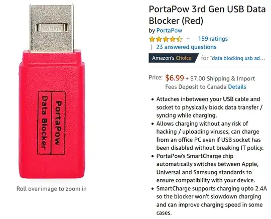

Here is a plug & play (literally) option:
charge only usb dongle
It's a good idea if you want to avoid pop-up messages and file browsers every time you plug your phone in for charging only.
This is also more fool-proof than the software approach because software that turns off the port for data can be reversed by software that turns it back on. Or it might be reinitialized during suspend/resume or some other process you didn't foresee.
I cut a piece of tape to fit the inner two data pins, and pushed it into place with a toothpick.
This is on my phone charging base so I shouldn't have to redo this tape job.
No more annoying popups, which were getting ridiculous. The last time I plugged in my phone I got 9 different popup windows, all of which had different error messages.
