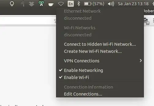

I am affected by the bug that occasionally my wifi connection is broken on resume from suspend. The problem manifests as follows:
Screenshot:
What are possible commands I can try to run from the command-line to reset my wifi connection without having to restart my system?
