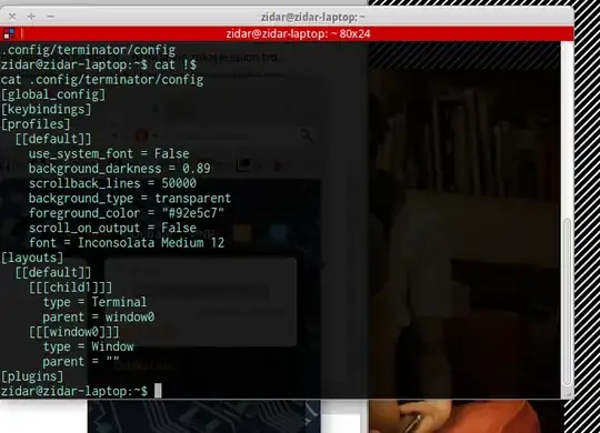

This is how it should look:
This is how it looks:

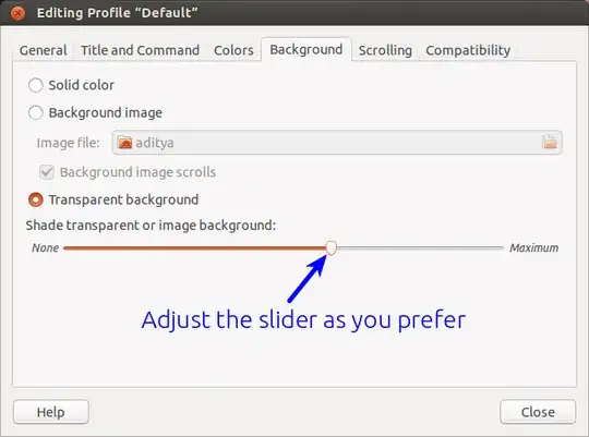

Navigate through Edit Menu → Profile PreferencesBackground Tab → Click the Radio button for Transparent Background and adjust the slider.
