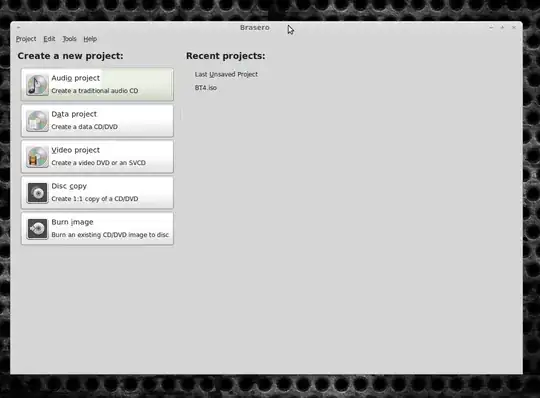

In brasero, you should be able to select new audio project, then drag and drop files.Freshly opened Brasero

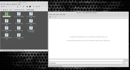

Drag files from nautilus window.
Of course you'll probably notice the files I'm using in this example are .ogg.
That's just another format for multimedia files. You'll want to drag .mp3 files since it sounds like you want them to play on a device that supports mp3.
