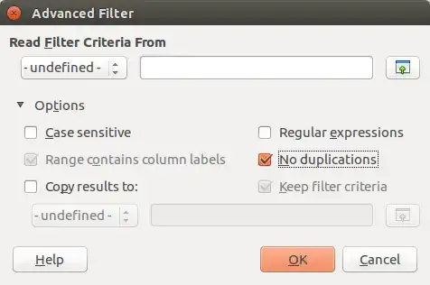

Libreoffice: Data → Filter → Advanced Filter → Options → Duplicate rows disabled
You can copy contents of both files into a sheet, remove the duplicates and create 2 new files if you want. That would need some kind of marker in the sheet so you can see file 2 started.
No special magic needed.
