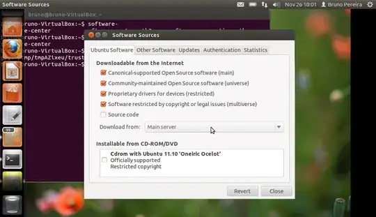

Press Alt+F2 and type software-properties-gtk.
Change the download location to Main Server or another server close to the country you live in and try to sudo apt-get update again.

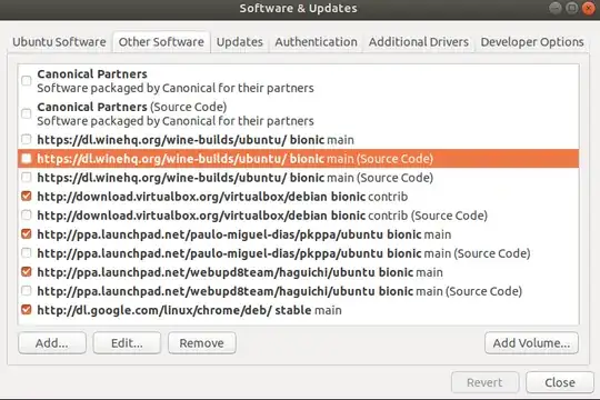

It seems that single enabled repository failing to update will cause this message. In my case, it was dl.winehq.org/wine-builds/ubuntu/bionic - I unchecked and no longer get error messages.
