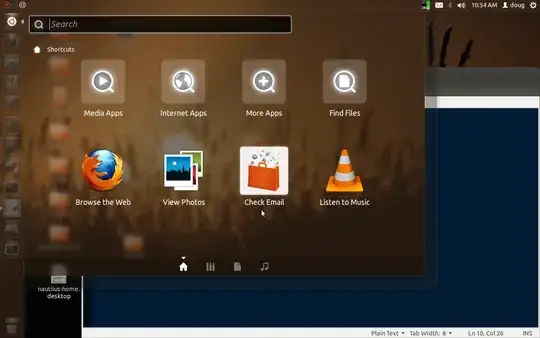

I removed all the icons in the sidebar because I'd like it to act more like a taskbar than a program dock. However, I now find it annoying that I must type "Software Center" into the Dash search bar whenever I wish to open it.
I thought it would be a good idea to put it right in the Dash home somewhere. Since I don't use Thunderbird, I thought to replace that icon with the Software Center. But as an Ubuntu Novice, I've got no idea on how to go about doing this.
Additional info:
My Dash home currently reads:
Media Apps-Internet Apps-More Apps-Find Files
Browse the Web-View Photos-Check Email-Listen to Music
I'd like it to say:
Browse the Web-View Photos-*Software Center*-Listen to Music
Any way to accomplish this? Thanks.
Ubuntu 11.10
Note - I don't particularly recommend this -
The "Check Email" is coded in, can only be changed in source.
If you did wish software-center to be used instead then you'd need to change the default handler for mail to software-center (mailto) which extends to more than just what happens when clicking on an icon.
If inclined to check out then open ~/local/share/applications/mimeapps.list & add this line in the [Default Applications] section (or edit to if already there
x-scheme-handler/mailto=ubuntu-software-center.desktop
A log out/in may be neededenter image description here
Can be reset to default in System Settings > System info > Default...
