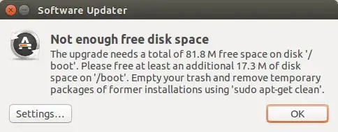

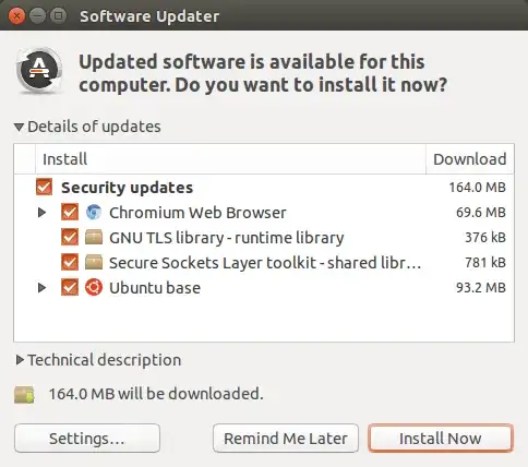

I am attaching two screen shots, self explained. Why do an update asking something regarding my boot sector? isn't dangerous?
muru
  • 207,228
Based on the images there seems to be very less space in /boot. You should remove your old and unused kernels following this
try this
sudo apt-get autoremove --purge
to purge manually installed kernels
sudo purge-old-kernels
