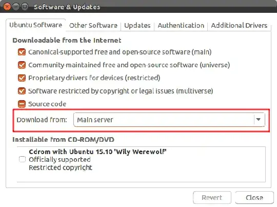

I am facing with same problem. From the errors you can see that you are using the Ubuntu Server in India. Change the update server to something other than India. Go to Setting > Software & update --- under Ubuntu Software tab, find the drop-down list to choose the server for downloading updates from. Choose main server.
See this:
