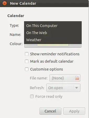

I did a clean installation of Oneiric and since Evolution is not included by default, I added it by doing apt-get install evolution. However, when I try to create a new calendar and sync it with Google I only get three options: "On This Computer", "On the Web" and "Weather". There used to be an option to include google calendars but it is not there now. It appears, though, in another computer that I upgraded from Natty so I assume that the option still exists. What package am I missing?

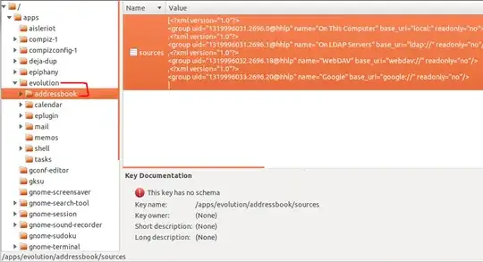

  • Install Gnome Config Editor
sudo apt-get install gconf-editor
  • navigate evolution -> address book :

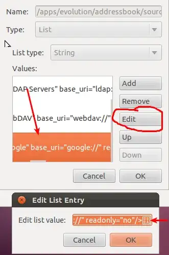

  • Double Click on the right side and find the Google part select edit an copy all the line (all strange character are important):

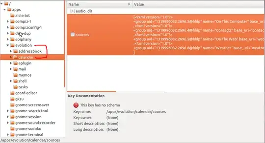

  • then navigate evolution -> calendar :
  • double click on the right side -> Add and paste the line you copy before ...

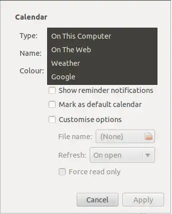

now you can see :
