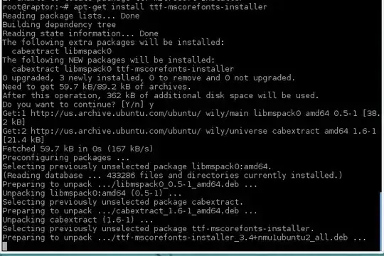

apt-get install ttf-mscorefonts-installer  preparing...

In this case, the apt-get command process just hangs without any other windows generated. Synaptic install attempt just ends with a "user did not agree to EULA" message. the package is in "a very bad inconsistent state" also described as "current status 'half-installed'". I am unable to install, uninstall, remove, autoremove, purge or configure.

# apt-get install ttf-mscorefonts-installer
Reading package lists... Done
Building dependency tree
The following extra packages will be installed:
  cabextract libmspack0
The following NEW packages will be installed:
  cabextract libmspack0 ttf-mscorefonts-installer
0 upgraded, 3 newly installed, 0 to remove and 0 not upgraded.
Need to get 59.7 kB/89.2 kB of archives.
After this operation, 362 kB of additional disk space will be used.
Do you want to continue? [Y/n] y
Get:1 us.archive.ubuntu ubuntu wily main libmspack0 amd64 0.5-1
Get:2 us.archive.ubuntu ubuntu wily universe cabextract amd64 <<not-a-link>>
Fetched 59.7 kB in 0s (167 kB/s)
Preconfiguring packages ...
Selecting previously unselected package libmspack0:amd64.
(Reading database ... 433286 files and directories currently installed.)
Preparing to unpack .../libmspack0_0.5-1_amd64.deb ...
Unpacking libmspack0:amd64 (0.5-1) ...
Selecting previously unselected package cabextract.
Preparing to unpack .../cabextract_1.6-1_amd64.deb ...
Unpacking cabextract (1.6-1) ...
Selecting previously unselected package ttf-mscorefonts-installer.
Preparing to unpack .../ttf-mscorefonts-installer_3.4+nmu1ubuntu2_all.deb ...
[**hang  ---  STOP FOREVER ---  NO-HIDDEN-WINDOW ---  NO-CURSES-WINDOWS**]
