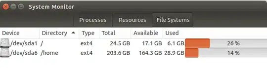

As a linux system security administrator & server manager?
Please open System Monitor. Select the File Systems tab. There you will see the current disk usage.

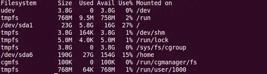

You can also do so from the terminal:
df -h

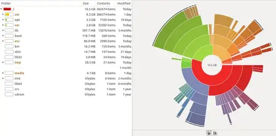

GNOME disk usage analyzer
An easy to use GUI tool to analyze use of storage space. It is my prefered way of analyzing disk space usage.
sudo apt-get install baobab
baobab
df - to check file system disk space usage
reversiblean@lenovo-g50:~$ df -h
Filesystem      Size  Used Avail Use% Mounted on
udev            1.9G     0  1.9G   0% /dev
tmpfs           385M  6.5M  378M   2% /run
/dev/sda4        25G   16G  7.5G  68% /
tmpfs           1.9G   58M  1.9G   3% /dev/shm
tmpfs           5.0M  4.0K  5.0M   1% /run/lock
tmpfs           1.9G     0  1.9G   0% /sys/fs/cgroup
/dev/sda2        96M   32M   65M  34% /boot/efi
/dev/sda5       260G  258G  1.2G 100% /home
tmpfs           385M   60K  385M   1% /run/user/100
