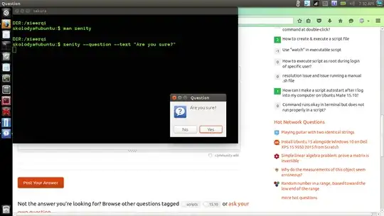

There is a way using zenity
zenity --question --text "Are you sure?"
You can test the exit status of that command with $? variable, something like this: if [ $? -eq 1 ];then exit 1 ; fi . 0 is OK , 1 is cancel. This construct will work well if you need to test exit status of the popup later, maybe store $? right after the popup exits to a variable. As discussed in the comments, structures like bellow will also work:

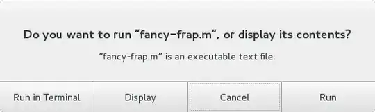

Indeed, Nautilus (Gnome file manager) will already by default ask you to confirm if you want to execute a script (or just open it in a text editor).
Nautilus confirmation dialog

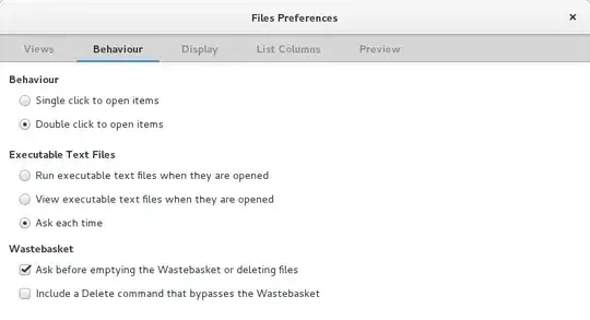

And of course, this behaviour is configurable, giving the user the possibility of turning it off (note entry on Executable Text Files).
Nautilus preferences menu - behaviour tab
So do not add an annoying confirmation dialog to your script. Configure your file manager correctly. And let your users do the same.

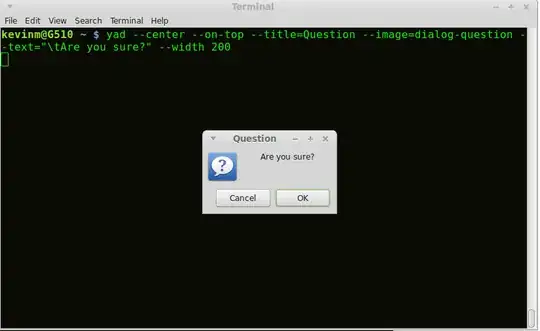

It would be better to put the box in the centre and also adjust the width of it, use a leading tab to position the text "Are you sure?" more to the right and also have it always on top. For this we need:
yad --center --on-top --title=Question --image=dialog-question --text="\tAre you sure?" --width 200
Most of the switches are self explanatory except for the "\t" before the "Are you sure?" which simply adds a tab space before printing the text. Now we should see this:enter image description here
The box is centred, always on top and looks better. To set a variable to test for which button was pressed, use:
yad --center --on-top --title=Question --image=dialog-question --text="\tAre you sure?" --width 200;result=$?;echo $result
In this example we are using the variable $result which will be set to 0 if OK was pressed or to 1 if Cancel was pressed.
