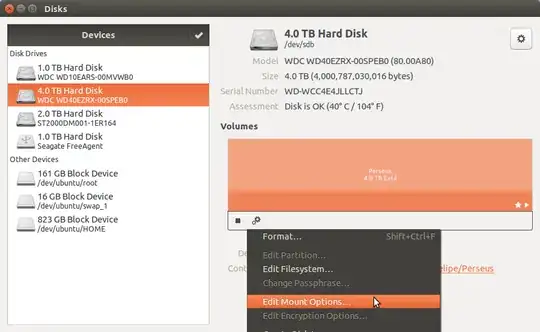

I recommend using the Disks app to do this. Open the Disks app from the Ubuntu Dash. Then simply navigate to the disk and partition that you want to mount. Then proceed to click on the gear icon for the specific partition and select the "Edit Mount Options..." as seen here:
In the new window dialog, make sure that "Automatic Mount Options" is OFF, and select the checkbox "Mount at startup". This will do the trick.
