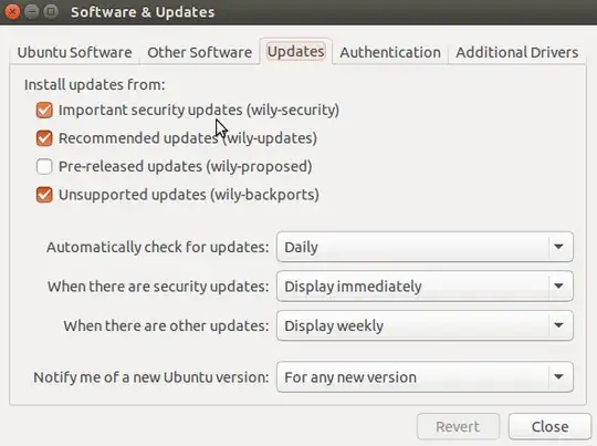

For most security updates such as this you should be able to rest easy knowing that if your version of Ubuntu is still actively supported you will automatically receive such important updates.
Check in 'Software & Updates' that you have the correct boxes checked to:
  1. Enable you to receive Security Updates
  2. Allow regular checking of the Repository
  3. Optionally automatically download and install Security Updates
Below is a screenshot showing you the relevant section of 'Software & Updates':
This screenshot is for Ubuntu 15.1 Wily Werewolf but will be the same through most modern releases of Ubuntu...
