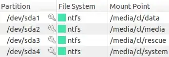

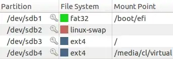

Below an example of a convenient disk partition setup for being used by multiple systems :
As you can see in the screenshots, the data partitions are separated from the system partitions.
They can be accessed from every operating system, in this case from non-Linux systems as well.
sdb is used for operating systems : sdb3 contains the Ubuntu system, sdb4 contains virtual disks.
sda is used for everything external : sda1 contains personal data, sda2 music, photos and videos.
sda3 contains backups of data and operating systems, sda4 (bootable) ISO files and various tools.
