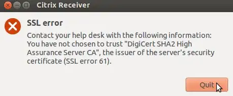

I am using Ubuntu 12.04.5 LTS and I have Citrix Receiver installed. When I am trying to login, I got the error:
You have not chosen to trust "DigiCert Hish Assurance Server CA", the issuer of the server's security certificate (SSL error 61)"
