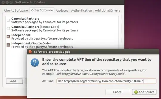

Screenshot here to demonstrate the technique:
