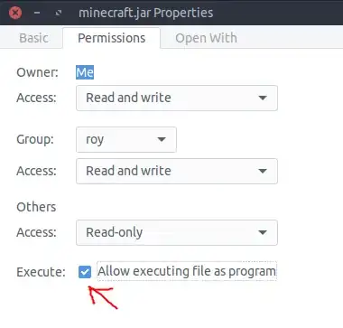

After JRE installation right click on the minecraft.jar file and go to Properties. Go to Permission and then select as "Allow executing file as program". Then go to Open With tab and select OpenJDK Java 7 Runtime and click on Set as default.
Now you are good to go. Just double click on minecraft.jar file.
