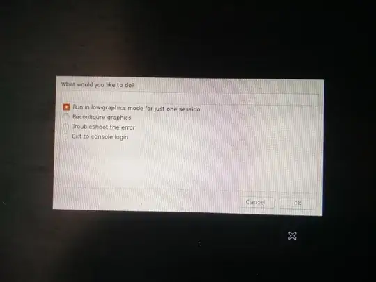

Are you getting screen like this? enter image description here
as mentioned in my thread
Your issue is unrelated to mine. Just undo the last action you did to get back into last working good configuration.
