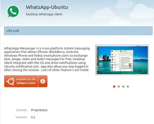

I made the payment, after that when I click on install it says "installing" but doesn't really download and install the whatsapp application .I am using ubuntu 14.04 LTS .If this problem can be solved please help me with that , else please tell me how can i get my money back

Whatsapp is 3 party software. If you have already paid the $4.00 for the service and can't use it i would file a report to the service provider. We cant help you recover your money we have no control over this. enter image description here
However before sending a report i would make sure you have followed the the guides recommend by whatsapp. That is listed below or here is the page.
