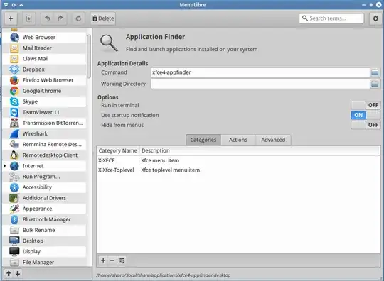

I want to reset the configuration and order of MenuLibre. How can I do it?
I try:
sudo apt-get --reinstall install menulibre
But the order of the app keep in the same way.
I throw off all the apps from his folders. Now I have something like (see photo). I want to reset this action.
MENULIBRE
