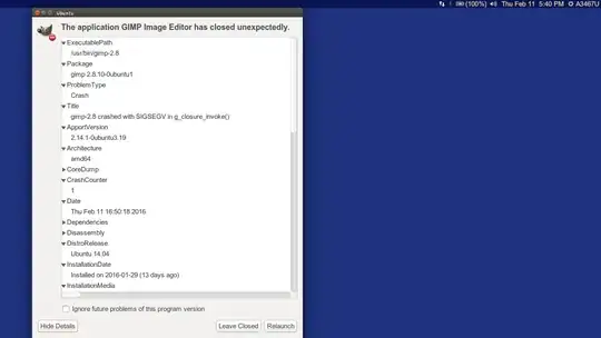

also there is a software crash notification gimp crash notice

i found a solution that worked for me . Just created a folder name .gimp-2.8 in my home directory
mkdir .gimp-2.8
do not use sudo and it solved my problem :)
