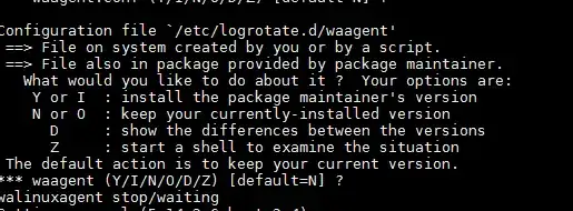

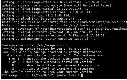

The intention of -y is to avoid interactive questions. If I run manually from a shell apt-get -q -y dist-upgrade it works fine until twice it gets stuck:
Parameter -y is supposed to avoid this situation. As you can see the offending package is waagent, that is Microsoft Azure Linux Agent and it comes installed by default when I finish step 1
My question is: How can I avoid these interactive questions? (either answering Yes, or No, or avoiding to upgrade this package or something else)
