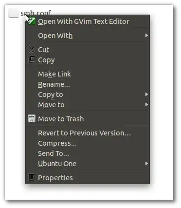

Right click on any text file and you will see like this:-
It works for me :)

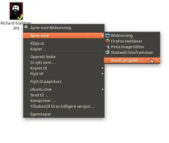

The option to choose what program to open an application with, is there, as can be seen in this screenshot.

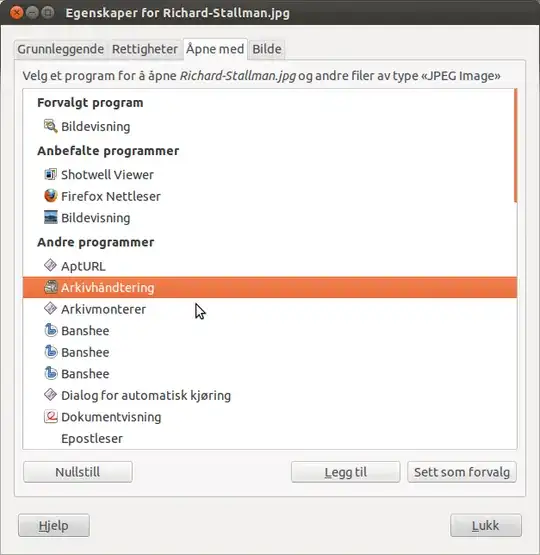

Or, you can open the Properties dialog (the one called Egenskaper in my screenshot) and choose Open With:
Then you can choose to show other applications:
When you add another application, then it will appear in the list to open with, as shown in the first screenshot, and you can choose to open with that application by default.
