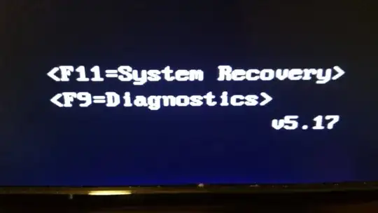

If you suspect that your hard drive might be dying, I suggest running some kind of diagnostic software - but only after backing up all of your data! Sometimes this is built into the computer, and can be run by either navigating to the Diagnostic tab in BIOS,
or there will be a key designated for this purpose, which you will have to press at startup.
