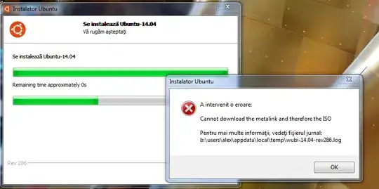

Here's a screenshot with the error message:
Sorry, I am Romanian . That's why is written in Romanian, but the problem has a bit of English.

This is not the recommended way to install Ubuntu.
Installing via Wubi is known for generating issues.
Create a properly working installation media.
Create sufficient free space for Ubuntu OS.
Write the Ubuntu ISO file to a DVD or USB.
Boot from this media and install Ubuntu.
Learn more : Ubuntu installation guide

I suggest you to install Ubuntu O.S. outside Windows O.S. Because, after launch of Ubuntu 12.04 and later version installation with wubi.exe is not working perfectly.
