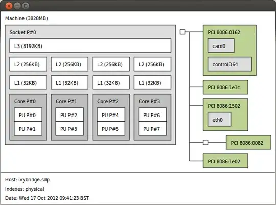

/sys/bus/cpu/devices/cpu*/topology/thread_siblings_list shows the layout of cores and hyperthreads. To make it easier to visualise, I recommend using the lstopo command, install with:
sudo apt-get install hwloc
and run with:
lstopo
My ivybridge desktop has 4 CPUs; each has a hyperthread, so we get a diagram with Cores P#0..3 and each has two PU's (one of these being the hyperthread):
If you want just a text version of this output, use:
lstopo -
