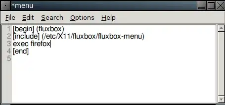

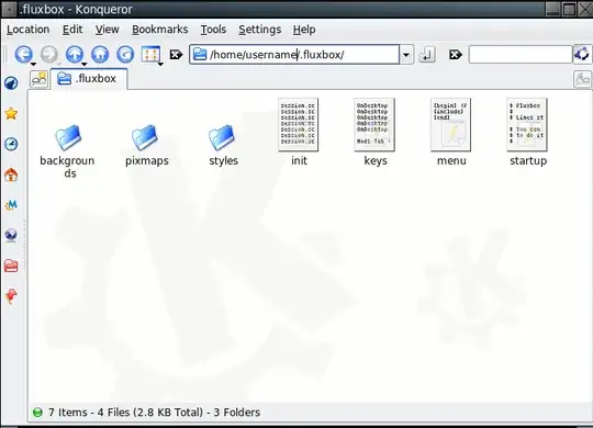

To configure fluxbox menu, you need to edit the ~/.fluxbox/menu file.
fluxbox menu file
fluxbox edit menu file
This file is just a text file, so you can edit it with any text editor. The fluxbox documentation explains the syntax of this file:
