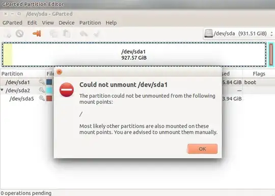

i've installed ubuntu 14.04 in single boot. My hard disk have 1tb capacity. While i'm trying to install windows in place of the ubuntu it shows no drivers are found error. So i'm decided to partotion my driver. For this i'm using gpartiotioner. But it shows that the driver could not not be mounted.I have read so many articles . But i've not get any solution for it. So plz help me

You cannot do this from within a running system.
You have to do the partitioning from a live media.
Boot from Ubuntu (DVD/USB) installation media.
Select Try Ubuntu without installing.
On the Live desktop open GParted ...
