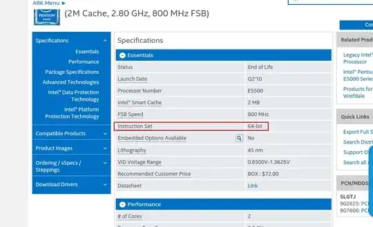

From Intel:
Raphael
  • 8,135
Your CPU supports 64-bit systems.
It can be seen in CPU op-mode(s).
