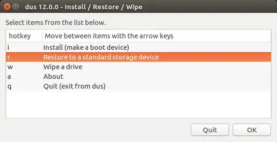

Restore a USB pendrive or memory card to a standard storage device
mkusb wraps a safety belt around dd. See these links
https://help.ubuntu.com/community/mkusb
mkUSB-quick-start-manual.pdf
mkUSB-quick-start-manual.pdf - alternate link
There is a more general description of what to do, if you have problems with a USB pendrive in the following link,
Repair the partition table and file system of a pendrive
mkusb can
  • wipe the first megabyte - often enough if you use a partitioning tool afterwards,
  • wipe the whole drive - takes a long time and causes wear,
  • restore directly - wipe the first megabyte and restore the drive to a standard storage device (with the MSDOS partition table and a partition with the FAT32 file system).
