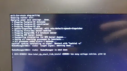

My Ubunutu 14.04 laptop will not shutdown anymore from the command line or from the reboot button in the OS. It hangs at the shutdown screen indefinitely. This problem started a few days ago when I tried to get bluetooth working on the laptop. I uninstalled and reinstalled some bluetooth packages, the exact names of which I have lost, and I may have used the --purge flag on the remove which may have deleted something important. I also can't get bluetooth working but I would first like to get my laptop to shut down properly before worrying about that.

However, sudo halt and sudo shutdown -h now stops at this ModemManager screen:
After many minutes the voltage retries message appears but that message also shows on boot so I doubt it's the cause of the problem.

After weeks of normal usage and hard-resetting the laptop, for whatever reason, sudo apt-get clean was what ended up solving the problem. I'm also having some dpkg errors now (probably related to the failed bluetooth package installations) but that clean command solved the hanging shut down.
