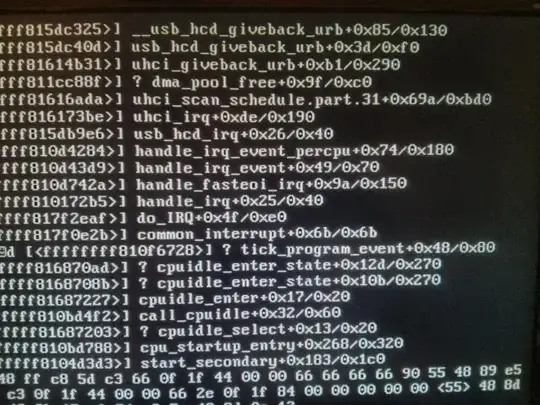

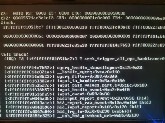

Silly me, I can scroll back and see the shutdown logs. If I print a stack trace when shutdown gets stuck, three cores are in cupidle_enter_state() or something like that, and the thread printing the stack trace has this trace:
Part 2
Part 1
Edit:
I thought about doing a swapoff before shutdown, so that perhaps the problem goes away. This showed that the swap is turned off at a super-slow rate of 8MB/s. This may be why the shutdown was so slow in the first place, perhaps it was doing a swapoff. swapoff being slow seems to affect many people. I'll investigate more and write an answer if I can manage to get something conclusive.
