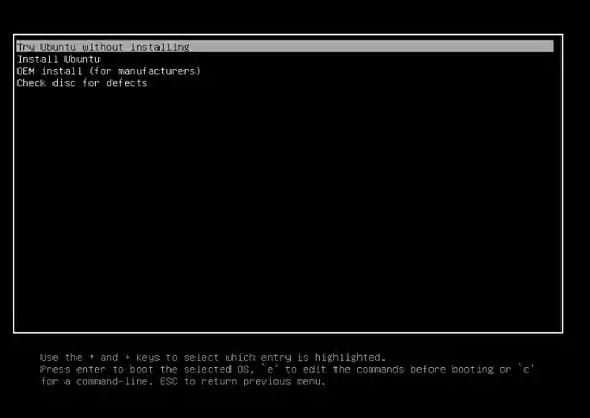

  4. The device should now reboot, and show you this:
Grub boot menu
Choose Install Ubuntu and press Enter

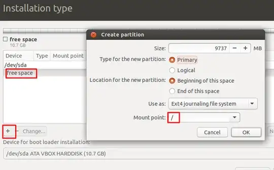

  3. Click the empty space you made with Windows Disk Management
  4. Press the + button to make a new partition
  5. Copy all the settings found in the picture below.
    Settings:
       Type = Primary
       Location = Beginning of this space
       Use as = Ext 4 Journaling File System
       Mount point = `/`

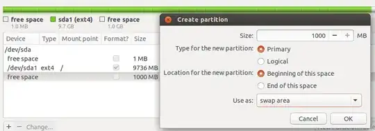

  1. Create another partition after the one you just created, Use As: Swap area
create swap partition
