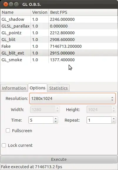

Globs ap
Installation - Found in Software Center
Simple benchmark program that has multiple opengl tests and shows best, average and worst FPS for each test.

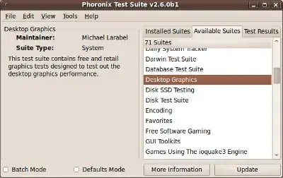

Phoronix Test Suite
Extensive Benchmark Utility. Includes several modules for Graphics to test out several Graphic technologies (Not just simple FPS counts).
