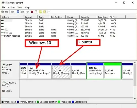

Assuming you have your Ubuntu partition beside the Windows 10 NTFS partition, like in this picture this picture, you first have to boot into Windows 10, and shrink the main Windows partition from there.
There are instructions on how to do that all over the internet, one here. You will see the new space as a black box in Disk Management marked as Unallocated Space.
