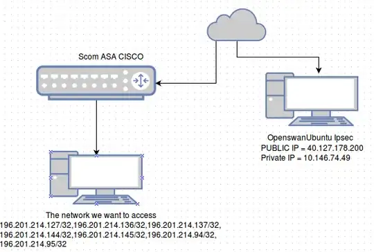

I've tried a week without any success to setup IPsec ESP authentication via a CISO ASA. This is the topology I'm trying to achieve here.
I want to connect to the network which is on the back of CISCO from the Ubuntu IPsec client machine itself. The Ubuntu client has only one eth0 interface.
On the CISCO both the server and the peer IP is set to the Ubuntu clients public IP.

With this config the tunnel comes UP. But actually the left IP should be the Public IP of Ubuntu openswan client right? The tunnel fails If I put the public IP as the left parameter.
If the topology I mentioned has to work, what am I missing?
