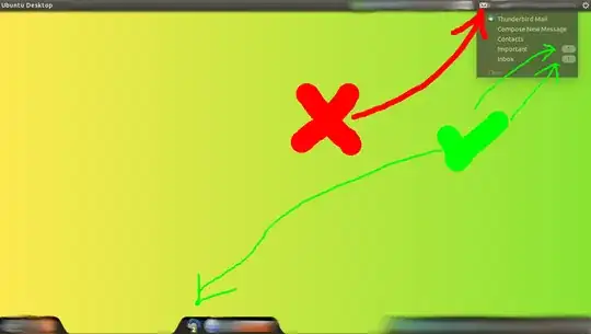

Problems:
  1. The main icon in unity-panel doesn't change when I receive an email.
  2. There is no pop up.
System setting:
  • Thunderbird is open.
  • Sound notification works.
  • Messaging Menu and Unity Launcher integration 1.3.1" in list of extensions.
  • Thunderbird 38.5.1
  • Ubuntu 14.04
  • My account is on Gmail.
Update1: I tried to install Web apps application with these instructions
sudo add-apt-repository ppa:webapps/preview
sudo apt-get update
sudo apt-get install unity-webapps-preview
It doesnt work.Now the number of unread emails even doesnt show up in the icon below the screen.
